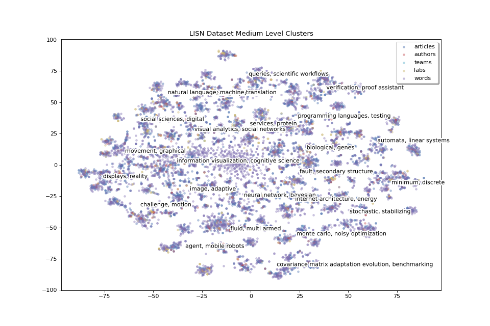

Now that we have 2D coordinates for our points, we can try to plot them to get a feel of the data’s shape.
labels = tuple(pipeline.natures)
colors = ['b', 'r', 'c', 'y', 'm']
fig, ax = pipeline.plot_map(matrices_2D, labels, colors)
pipeline lisn lsa tsne kmeans
The plot above, as we don’t have labels for the points, doesn’t make much sense as is. But we can see that the data shows some clusters which we could try to identify.

With medium level clusters we have a finer level of detail:
clus_scores_ml = clus_scores[1]
clus_mat_ml = clus_2D[1]
fig_ml, ax_ml = pipeline.plot_map(matrices_2D, labels, colors,
                                  title="LISN Dataset Medium Level Clusters",
                                  annotations=clus_scores_ml.index, annotation_mat=clus_mat_ml,
                                  annotation_color='black')
We have 24 medium level clusters. We can increase the number of clusters to have even finer details to zoom in and focus on smaller areas.
