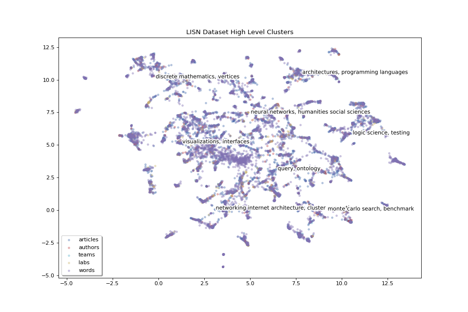

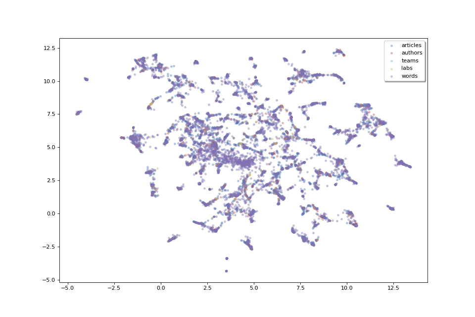

Now that we have 2D coordinates for our points, we can try to plot them to get a feel of the data’s shape.
labels = tuple(pipeline.natures)
colors = ['b', 'r', 'c', 'y', 'm']
fig, ax = pipeline.plot_map(matrices_2D, labels, colors)
pipeline lisn lsa umap kmeans
The plot above, as we don’t have labels for the points, doesn’t make much sense as is. But we can see that the data shows some clusters which we could try to identify.

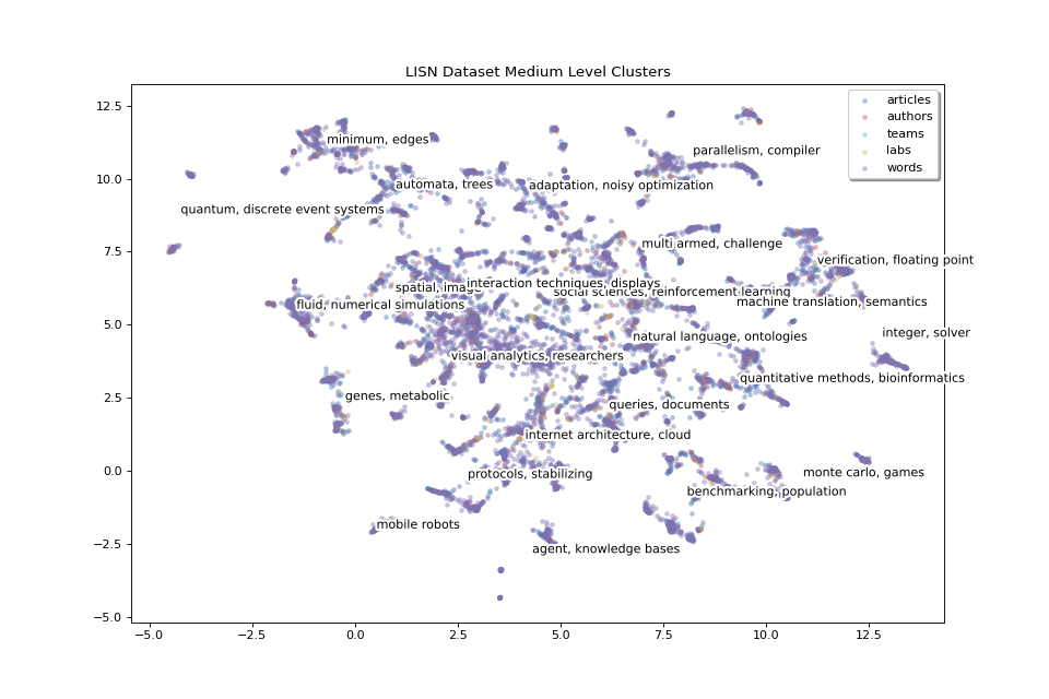

Clustering
In order to identify clusters, we use the KMeans clustering technique on the articles. We’ll also try to label these clusters by selecting the most frequent words that appear in each cluster’s articles.
from cartodata.pipeline.clustering import KMeansClustering  # noqa
# level of clusters, hl: high level, ml: medium level
cluster_natures = ["hl_clusters", "ml_clusters"]
kmeans_clustering = KMeansClustering(n=8, base_factor=3, natures=cluster_natures)
pipeline.set_clustering(kmeans_clustering)
Now we can run clustering on the matrices.

We will now display two levels of clusters in separate plots, we will start with high level clusters:
clus_scores_hl = clus_scores[0]
clus_mat_hl = clus_2D[0]
fig_hl, ax_hl = pipeline.plot_map(matrices_2D, labels, colors,
                                  title="LISN Dataset High Level Clusters",
                                  annotations=clus_scores_hl.index, annotation_mat=clus_mat_hl)
The 8 high level clusters that we created give us a general idea of what the big clusters of data contain.
With medium level clusters we have a finer level of detail:
clus_scores_ml = clus_scores[1]
clus_mat_ml = clus_2D[1]
fig_ml, ax_ml = pipeline.plot_map(matrices_2D, labels, colors,
                                  title="LISN Dataset Medium Level Clusters",
                                  annotations=clus_scores_ml.index, annotation_mat=clus_mat_ml,
                                  annotation_color='black')
We have 24 medium level clusters. We can increase the number of clusters to have even finer details to zoom in and focus on smaller areas.
